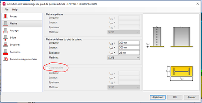

Hi everyone, can you help me, please! how can i activate the option of ''contre - platine'' in French version of post foot assembly:

Hi @duc.dt
It applies only for the older French code CM66.
