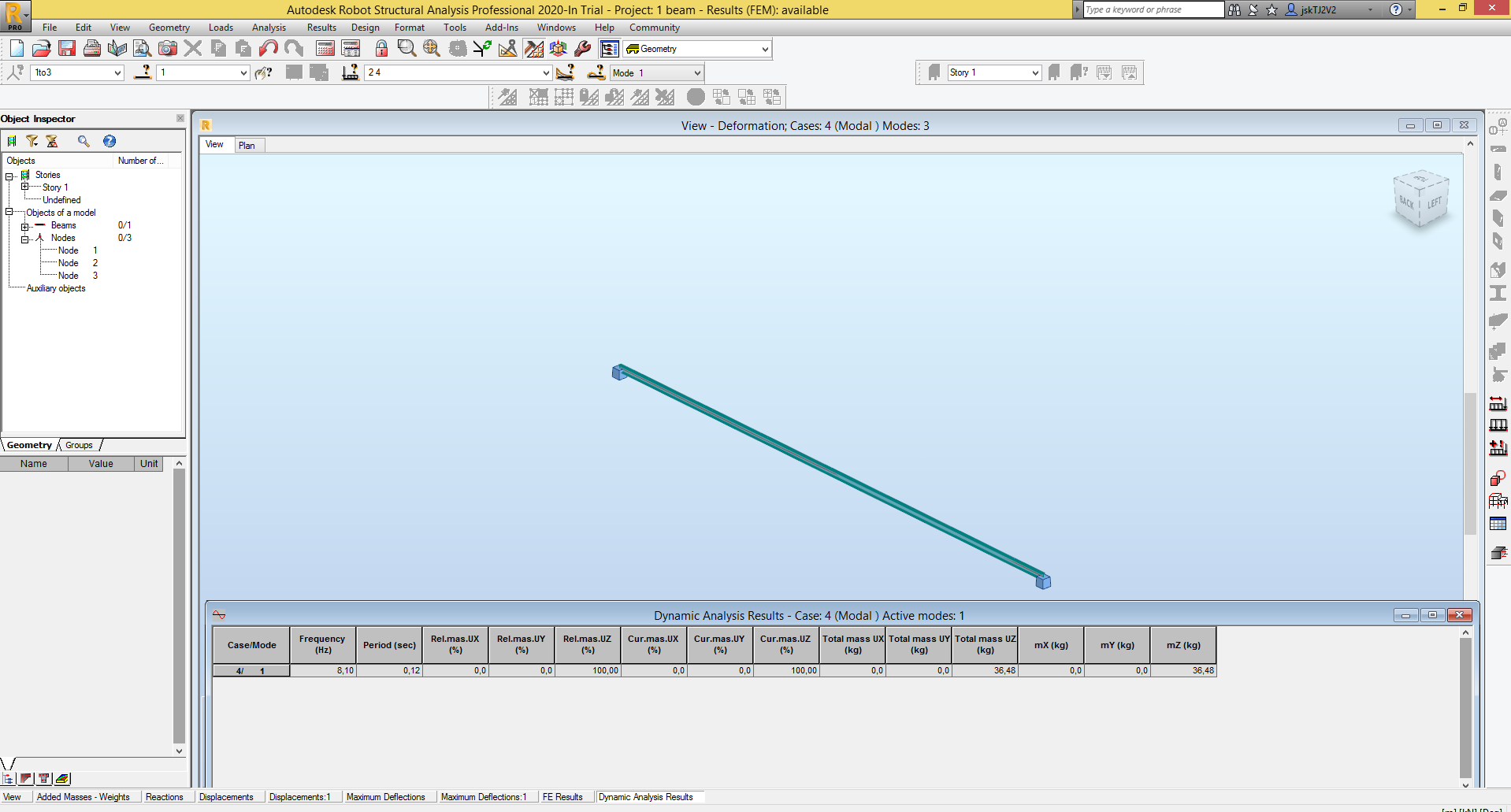

I am currently testing out robot but have some years of experience with modal analysis in other softwares. I have to issues:
1) In my simpel beam model I want to include 10 modes in the results, but I dont know how to tell robot that I want this. It only gives me 1 or up to 4 modes. (maybe due to a too few numbers of nodes?)
2) The modal mass is equal to the total mass. This shouldn't be the case. The modal mass is ½ of the total mass for the 1. mode of a simple supported beam and even lower for a clamped-clamped as in my example.

Hi @Anonymous
You may tell Robot the number of desired mode here
If you want to upload your model, zip it before

Hi Simau,
Thanks. Im am writing 10, but the it says it can only find 1 (or 4).

Simau
You must create intermedite nodes. The more the number of nodes, the more modes.
Create nodes with: edit>divide then
M. Agayr
That solves both issues - thanks !
