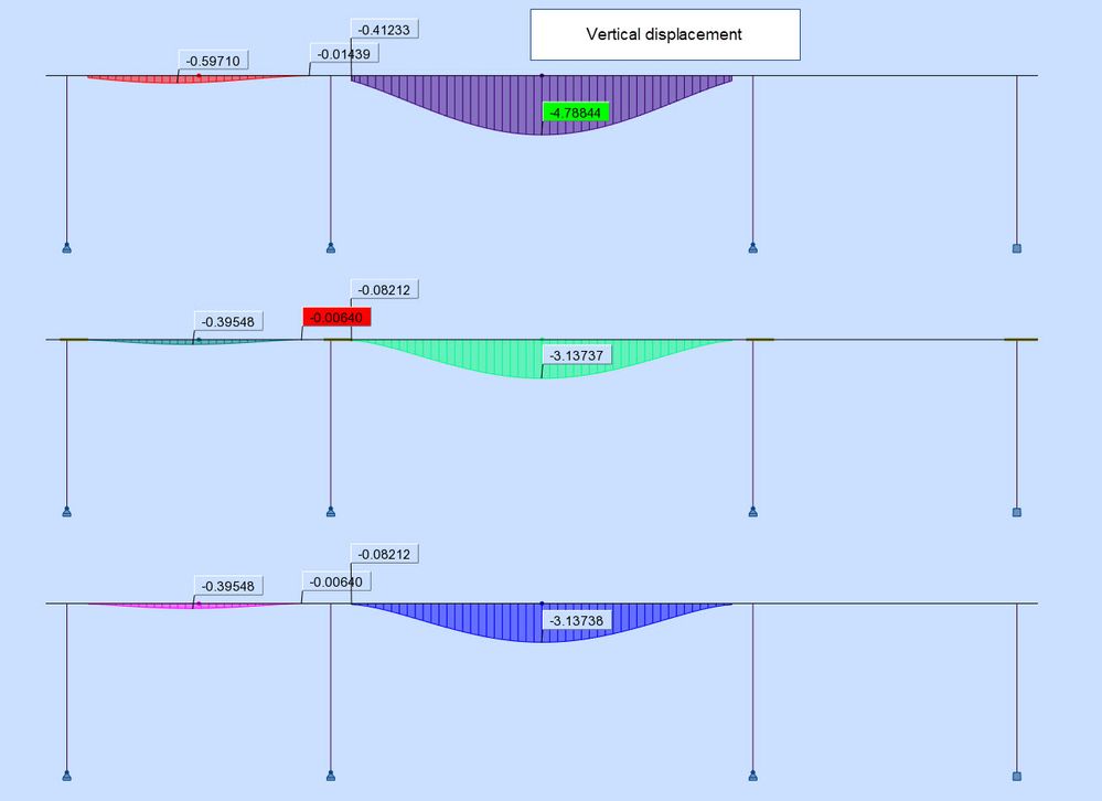

Greetings all,  please advise on the following observations
 below are to identical simple floors. one with rigid link defining the column contour and one without.
i made a cut at column edge for both floors at exactly the same location. once with smoothing and once without; the moment difference is almost 100% for the first internal column
also regarding the columns moment, the difference is more than 100%
so please advice on which modeling way is better in reflecting the real behavior?
col size is 400mm x800 mm, mesh is 150 mm
model is attached
model is attachedpanel cut rigid vs no rigid.PNGpanel cut rigid vs no rigid smoothing within panel.PNGcol moment rigid vs no rigid.PNG

Hi @me1205377
Looking at three models (the 3rd one being with a beam instead the panel):
1. For a model model with rigid links the values of reactions are the same as for the equivalent beam model but when you reduce slab stiffness (Ig) then rigid links will 'overwrite' this reduction above the columns.
2. The values for smooting within the panel and no smoothing are very close but the prior reduces the peek over the columns.
Knowing the above the decision is now in your hands  Smiley Happy

We were talking about new features for Robot and"Rigid zone for slab columns " came to the discussion
"This should be build in order to not have problems with diaphragm "
"As you know you cant have slave nodes for 2 master nodes"
    Thinking about this issue of diaphragm "hidden" rigid links interfering with rigid links created to model Rigid zone for slab columns , I realized it can be done properly using what we have in Robot today .
  I tried on the model of this thread and it seems that it works very well.
  Instead of using Rigid links on the nodes inside the columm section area , I created a panel with the size of the columm cross section with the same concrete material but with huge E value( young modulus).
  This way it would not interfere with the rigid links due to diaphragm setting.
As you can see below , results are identical for the 2 models.
rigid zones - panel cuts.jpgrigid zones - vertical displacement.jpgrigid zones - moment and reactions on bars.jpg
Rigid links like those can be easily created using the  Roman "Spider/diaphragmer" .
But probably our great API master can also create the "Huge E panels" with not so many trouble.Smiley WinkSmiley WinkSmiley Very Happy
