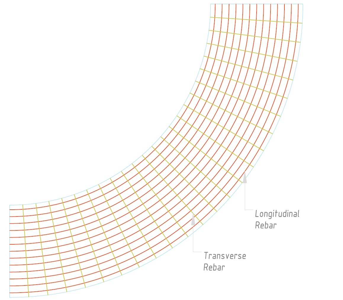

However, working with materials and loads (depnding by the construction method of the stair) I found a possibly solution. My question now is that:
How can I set the reinforcing direction parallel and orthogonal to the midline of the complex slab? I'd like to use curved bars for longitudinal rebar and radial ones for transverse rebar, as shown in the following picture:
How can I do this??????

Artur.Kosakowski
Autodesk Support
Autodesk Support
Like that?
Artur Kosakowski
Message 14 of 17
StefanoPasquini6790
Absolutely perfect, this is the right model.....
