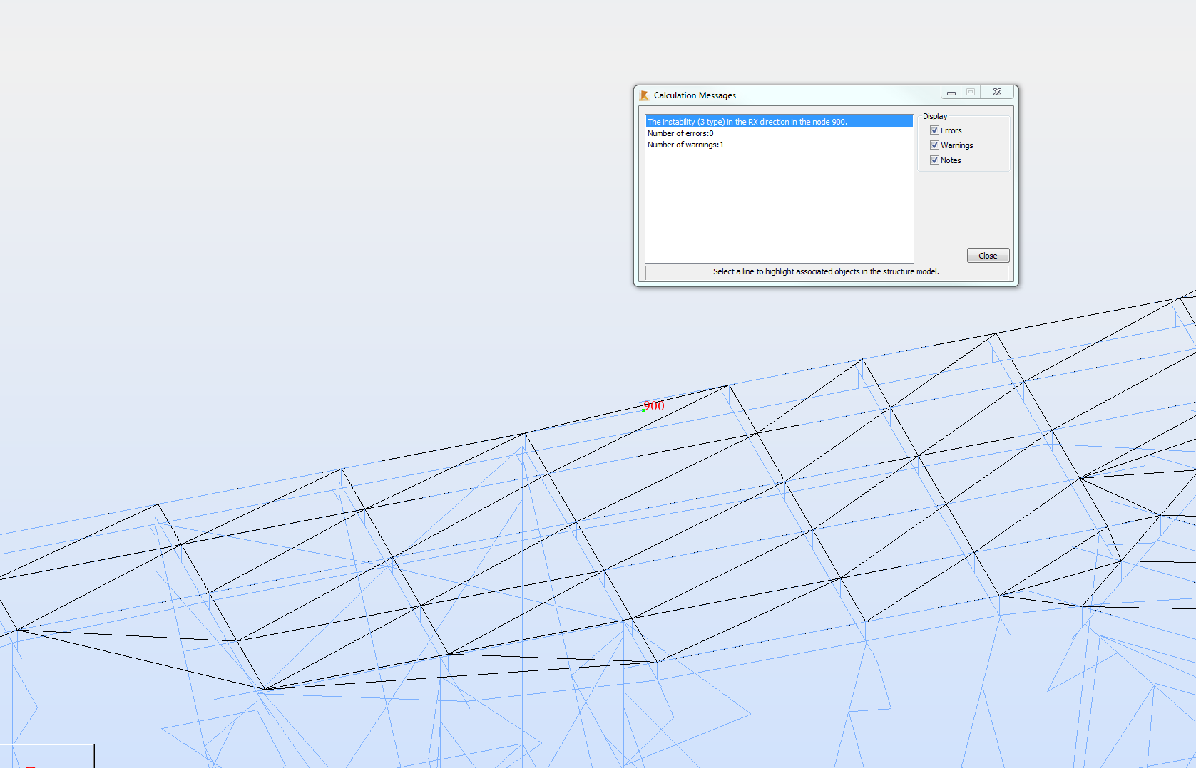

Hi all,
Recently I've transferred to Robot 2016 and there is difference in the Node/bar visualization after selection. The working screen fades away when I select the node with instability  and the rest of the model turn invisible with the time.  It makes it hard to connect the point to the adjoining bars. I presume the whole idea behind is to ease the  search of any instability nodes.
Please, if there is a way to turn off this type of visualization, let me know. I'd like to adjust the settings to something similar in Robot 2015.
P.S. Attached are 2 images to bring more clarity on what I mean.

Reply (1)
Muhammed.OPERA
Hi @Anonymous
Try to reduce the hardware acceleration in the view parameters.
