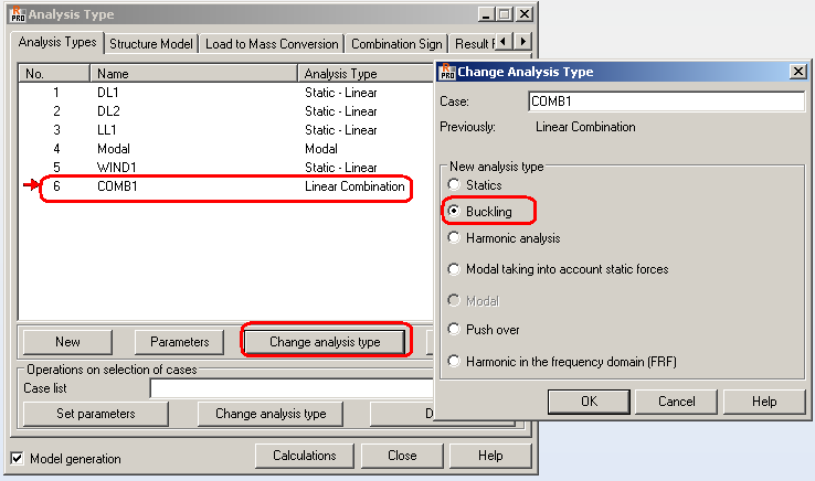

Question from the user:
We would like to run a buckling case with dead load and wind. Is this possible?

It is enough to define a combination of appropriate load cases and define buckling analysis for it - see the attached screen captures.
