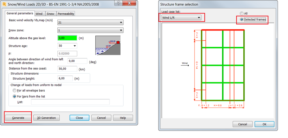

If you already have 3D model with claddings, some way to at least partially use automatic generation of wind loads according to BS-EN 1991 may be:
1/ extracting one frame from this model with Y=0, changing it to 2D frame and saving
2/ for such additional 2D model running automatic generation of wind loads specifying total depth of the structure corresponding to the real one
3/ running generation for specific frames (from specific wind load zones: edge, central)
4/ using the loads from calculation notes to manually define appropriate loads in your 3D model
5/ repeating steps 3/ and 4/ for various zones and frames
I know that such approach requires a lot of manual work to transfer loads from 2D to 3D model.
On the second screen capture you can see "3D generation" button - it enables automatic "extrusion" of 2D frame into 3D simultaneously with automatic generation of wind loads - but it works only for equal spacings of frames.
