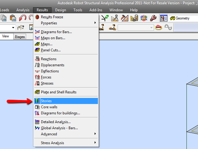

Hi
    In Autodesk Concrete Building Structure 2011
     How can I enable the option to find the center of torsion of the building?. After run the analysis the option to view the center of torsion and gravity are disable.
    It is possible to find the center of torsion in Robot Structural Analysis?

Please use the RSA forum to post question about RSA and ACBS:
 http://forums.autodesk.com/t5/Autodesk-Robot-Structural/bd-p/351

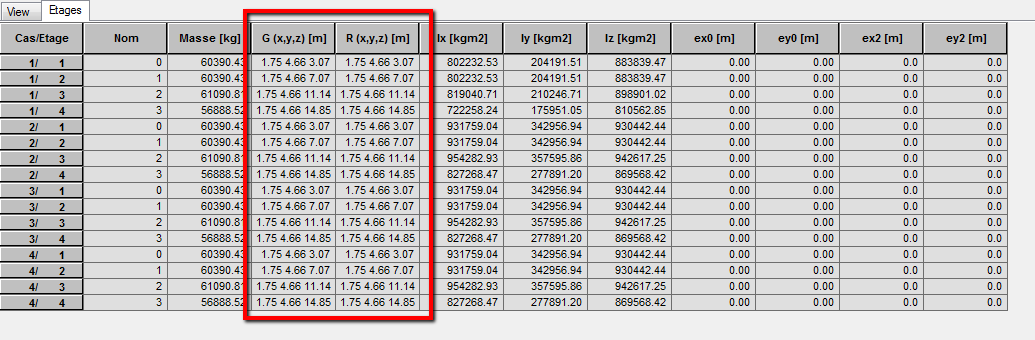

If you use the 3rd method of calculation (F.E.M) and Dynamic analysis you should have access to G and Tgt.png
On RSA, You've to choose Stories-> values
and :
