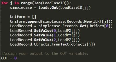

This is how i use it, by using the "identification numbers" of the properties.
In your case add just an extra LoadRecord.SetValue(11,....)

Hi @1234eddie
Thanks you reply. I made it work very good
