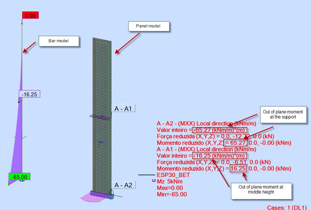

I'm now interested in doing the same thing on panel cuts to get Moments and Shear force.
It seems like I can simply use reduced forces and reduced moments. My moments appear to be correct.
But why is the integral value not correct? I thought that Myy would be the correct choice, but the moment is close to zero. Mxx and Mxy is also very low. Do I need to define the cut elsewhere?
If reduced moments and forces is correct, I'm happy to use that. But would simply be curious to understand WHY this is so.
Thanks in advance!
Please see attached picture.
Message 18 of 22
Rafacascudo
Integral value of a cut will only work for out of the panel plane moments.
So it will be "local direction of the cut" direction and Mxx
Rafael Medeiros
Message 19 of 22
Rafael,
Thanks.
I figured out of the plane would be xx. Regardless, when using xx, I do not seem to get the correct moment values and reduced moments and integral value is not the same. And I don't quite understand why?
Thanks in advance.
EDIT: Since I had other questions, I also made a similar post yesterday.
Message 20 of 22
Rafacascudo
But it is correct!!!!!
You should be looking at the Reduced moment about the X axis (global coordinates) . The value shown is zero which is correct for the loads applied . And it agrees  with the integral value of the cut which is also ZERO.
The large value 958,46 is for the moment about Y axis(global coordinates) ,which is the in-plane moment at the panel base.
Rafael Medeiros
