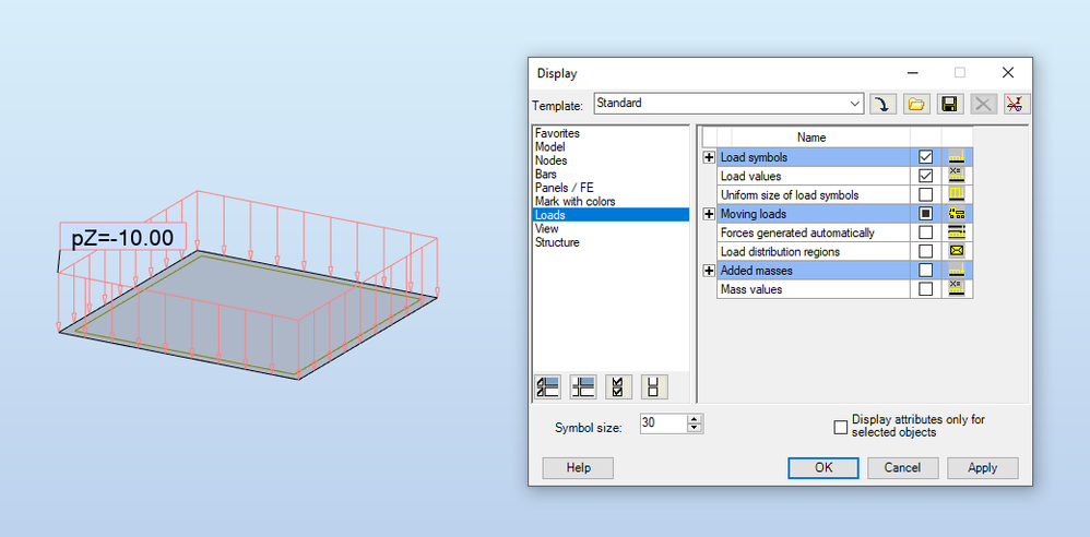

I want to apply a uniform load, but I couldn't find something similar. Any help would be greatly appreciated. Thanks in advance.

salut  @tiromos
Vous pouvez trouver des exemples similaires dans le guide de démarrage de l'API Robot dans le répertoire SDK
Sub CreateCladding()
  Dim RobApp As RobotApplication: Set RobApp = New RobotApplication
  If RobApp.Visible <> -1 Then
    MsgBox ("OPEN ROBOT FIRST!"): Set RobotApp = Nothing: Exit Sub
  End If
  Dim points As RobotPointsArray
  Set points = RobApp.CmpntFactory.Create(I_CT_POINTS_ARRAY)
  points.SetSize 4
  With points
    .Set 1, 0, 0, 0
    .Set 2, 1, 0, 0
    .Set 3, 1, 1, 0
    .Set 4, 0, 1, 0
  End With
  RobApp.Project.New I_PT_SHELL
  With RobApp.Project.Structure.Objects
    .CreateContour 1, points
    With .Get(1)
      .SetLabel I_LT_CLADDING, "Two-way"
      .Update
    End With
  End With
  Dim CaseLive As RobotSimpleCase
  Set CaseLive = RobApp.Project.Structure.Cases.CreateSimple(1, "Live", I_CN_EXPLOATATION, I_CAT_STATIC_LINEAR)
  With CaseLive.Records.Create(I_LRT_UNIFORM)
    .SetValue I_URV_PZ, -10000
    .Objects.FromText 1
  End With
  Set RobApp = Nothing
End Sub
 Cordialement
Stéphane Kapetanovic
don't forget to accept the solution and leave a < like !

1. Yes, it does work, thank you very much. Could you please add one more load and one combination to the code?
2. try my code first as it is consistent and concise -> truth be told, my code seemed like black magic to me.
Stephane.kapetanovic
1 - What loads?  (API) Load Combinations , Contour Loads , Linear Load 2P
2 - Your code creates a panel as well except the cladding label. Don't worry. If it's a panel without curves, the CreateContour method is simpler and faster.
