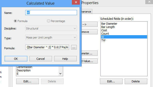

I'm not really sure but based from my experience to calculate the weight of rebar in Revit, the steps are as following:
  1. Adding the bar diameter, quantity, bar length and (bar diameter^2) in scheduled fields
  2. Click on Calculated Value button and insert Density of rebar as constant value (7850 kg/m3)
  3. Adding the Reinforcement Area and Reinforcement Volume
  4. To get the reinforcement weight as shown below
undefined
Finally, to get the total weight of rebar, just multiply the rebar weight per unit with quantity.
undefined
It works for me but if anyone have another correct way, kindly share with me. Smiley Happy
how do you add the  (bar diameter^2) ? its not in my parameters
KrisAribal
In the schedule properties, create a new calculated value and use this formula: (bar diameter*bar diameter)

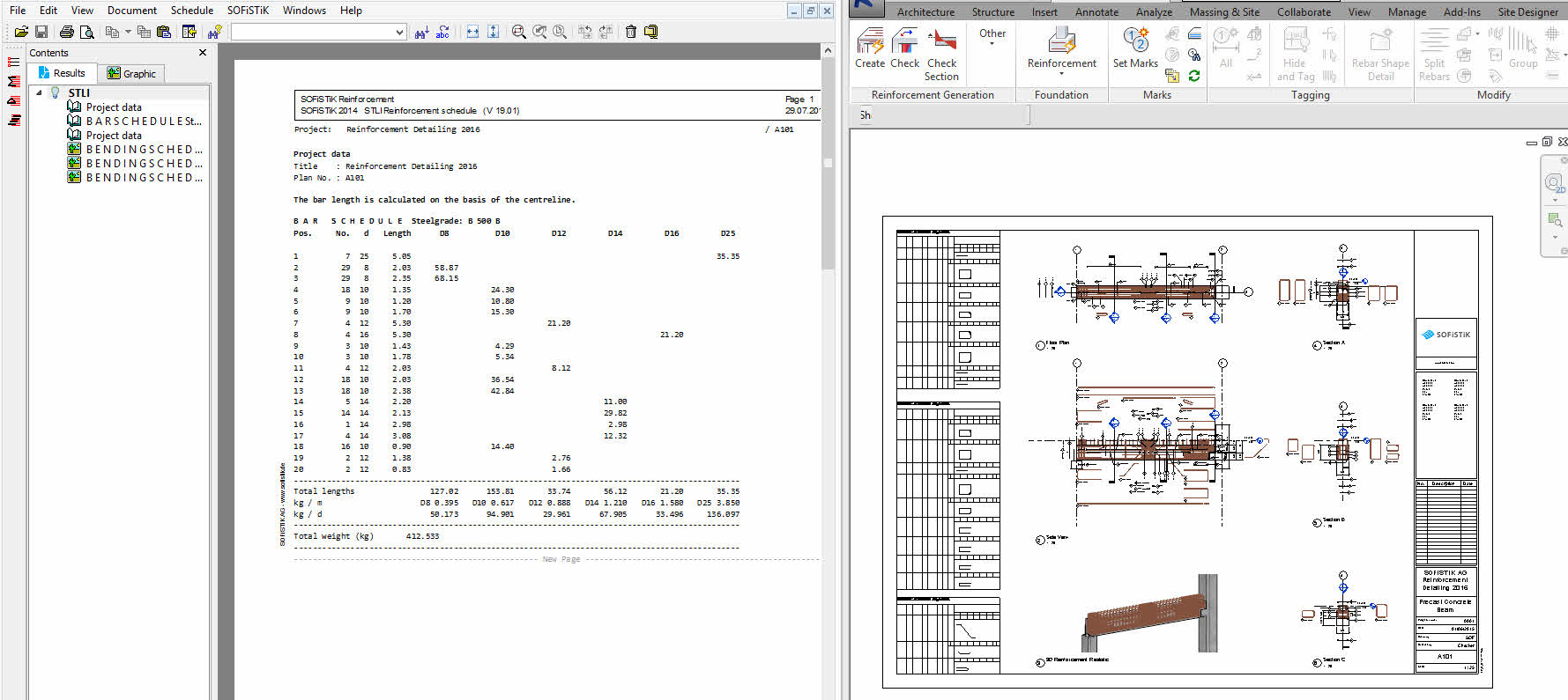

there is another possibility to calculate the total weight and get a bar schedule. You can use the plug-in SOFiSTiK Reinforcement Detailing and get a document with some nice tables and bending schedules.

Yes, I also use Sofistik Detailing to generate automated bar bending schedule. Smiley Happy

The only way I found is this:
1. Create a Project parameter e.g. Rebar_Sheet and fill it out for every rebar.
2. Use this parameter in your schedule in order to filter only these rebars that are assigned to your desired sheet.
3. Calculate the volume (Schedule: > Edit Fields > Calculate Value... and use the parameters Bar Diameter and Total Bar Length
4. Calculate the weight (Schedule: > Edit Fields > Calculate Value... and use the parameter volume and multiplicate it with the density (there is no parameter for that, just write down a number in the formula.
4. Edit Formatting and click on Calculate totals for your new parameters.
Does it work?
