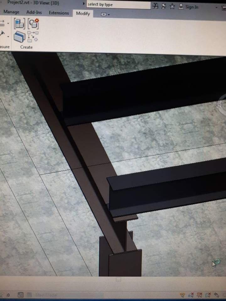

Hi All,
I have a problem,when I make section or level for printing but... the line for the main beam is shown as continuous even the secondary beams are above the mean beam, I tried to make it cut under the secondary beams but it doesn't work.
any one can help?
637 Views
MostafaElashmawy
Actually what you see is hidden lines (dotted lines) but the problem is that the dots are too large in the used scale.
make the scale of the view 1:1 and you'll understand what I mean.
the solution could be to change the line pattern for hidden lines of structural framing or to just hide the hidden lines in view.
check below photos.

Dear Mr.Mostafa ,
I make as you said and it is working, also there is option in the properties it's also useful for visibility of hidden lines as the photo.
 Thanks Mostafa for your help.
