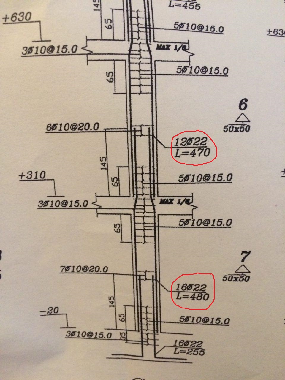

HOW CAN I TAG VERTICAL REBAR OF COLUMN IN ELEVATION VIEW LIKE THIS PICTURE?
photo_2018-03-05_14-50-44.jpgHOW CAN I TAG VERTICAL REBAR OF COLUMN IN ELEVATION VIEW LIKE THIS PICTURE?

Message 2 of 8
MostafaElashmawy
select the rebar tag then edit family.
inside the family edit the label to be similar to below photo.
let me know if further assistance is needed.

Message 3 of 8
hi eng. mostafa
thx for ur answer
but i want tag all of vertical rebar in column with one tag
for example 16 Φ 22 but this tag 1Φ22 or 5Φ22
and MRA don't work for vertical rebar
Message 4 of 8
MostafaElashmawy
in that case you will need to use external plugin
sofistek for example.
Mostafa Elashmawy
