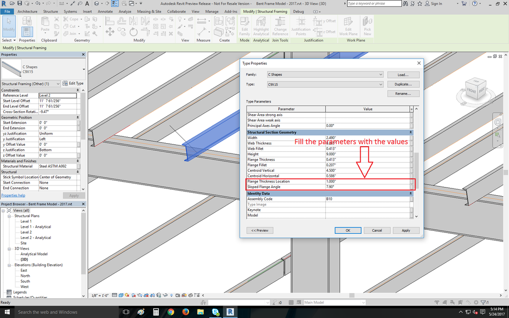

I encountered a problem with steel connections.
I am just trying to place a simple beam - column connection. But i get this error; 'Incomplete structuralSection parameters'. I allready checked the section shape in the family, for both families it on 'I-shape Wide Flange'. So this seems to be correct, right?
3,022 Views
mihai.sandu
Hello Merlijn,
The issue is caused by the fact that there are missing values in the "Structural Section Geometry" category of the beam definition.
Please see bellow pictures, in which I displayed how you can correct such a situation.
Incomplete parameters.pngStructural Section Geometry.pngFill missing values.pngConnection is created.png
