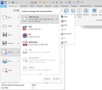

What are you trying to use the .STEP for?  In Full 2025
You can Export to .STEP
you can  Link & Import .STEP

jay_colcombe
If you do not have it in the options as shown above, then it is not possible, and the Help is incorrect!

tuomas.tahvonen
I don't have that option in Revit LT 2025-4. So unfortunately the information at Autodesk Revit LT 2025 enhancements -site was incorrect.. That would have been useful improvement.. Thank you for help.
