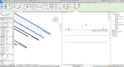

jay_colcombe
A quick check with the LH-Series & BG Series shows it working as expected both have a Construction Start & End Offset of 1000mm  Is it related to the view and you cannot see the Top Chord?

jay_colcombe
do you have a Site plan in you model?  If so try opening this can seeing if it make a difference on the extensions
Mine are fine under Coarse LOD

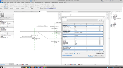

jay_colcombe
Check in the Family to see the the Model Line is adjusting as expected, this is the LH Family

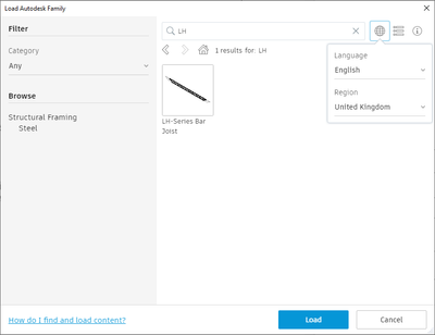

jay_colcombe
This is an OOTB Family for Revit 2023 i never use these families so there is no need to change them.

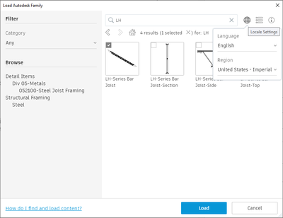

They are from the UK library not US.  you can download and check from Insert Tab  > Load Autodesk Family > Change the Region
I just downloaded the US version and works fine
