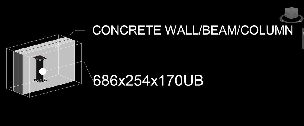

I have encountered a steel beam to concrete connection. Actually the beams are to be installed using Post-Installed anchors from HILTI on some point I was able to model the connection but no Code Checking is available on the parameters. Can someone help? Thank you.

Hi @rsalvadorMCPP5
Did you try that with HILTI profis anchor design software ?
You can download that from hilti website for free. Just you have to register your profile on that website.
https://www.hilti.ae/c/CLS_CUSTOMER_SOFTWARE/CLS__SOFTWARE_FASTENING_SYSTEMS
https://www.youtube.com/watch?v=ZBHWRD-68ag
