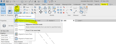

No worries is really easy, you have to select in a 3d view all your model elements, then use the cut or copy, in the paste dialog select aligned to selected levels.
If you have some anotation elements you can also copy both the annotation and model to move all the elements.

I also reccomend you save selection of the model elements in 3d view.
then go to the floor plan where you have the annotations like dimensions, tags, text and so on, in manage tab, click on edit selection
add elements to your selection, then finsh
Now you can load the entire floor with annotations cut and paste in selected views, the selected levels aren't available when you want copy paste annotations and model elements.
