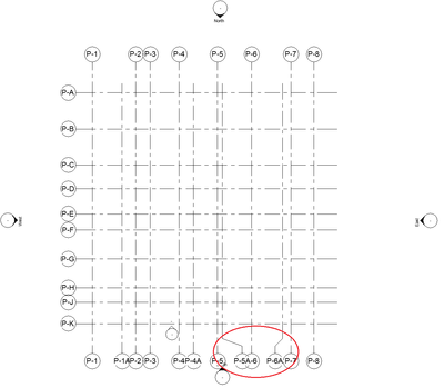

hi all,
I have placed grid lines. And I added jogs to the grid bubble, so that it is easier to see.
But this alteration which I did are not reflected in other plan views. How to propagate the changes in all levels?
Do I have to do this in all levels? The 3D icon near the grid bubble was not helpful.

To propagate grids and levels 2d extent, you must Uncheck View crop for both source and target views.  When done, you can re-check View Crop for those views.
ranga.narasimhan
May be I did not ask my questions properly. The grid lines are already visible in all levels. But the jog (bend) that I added later on, to the grid bubble, is not reflected in all levels.
Do I have to do manually on all levels?

hi @ranga.narasimhan
I hope this helps you.
https://autode.sk/3wu0n9q

You nailed it! Perfect. Thanks a lot.
