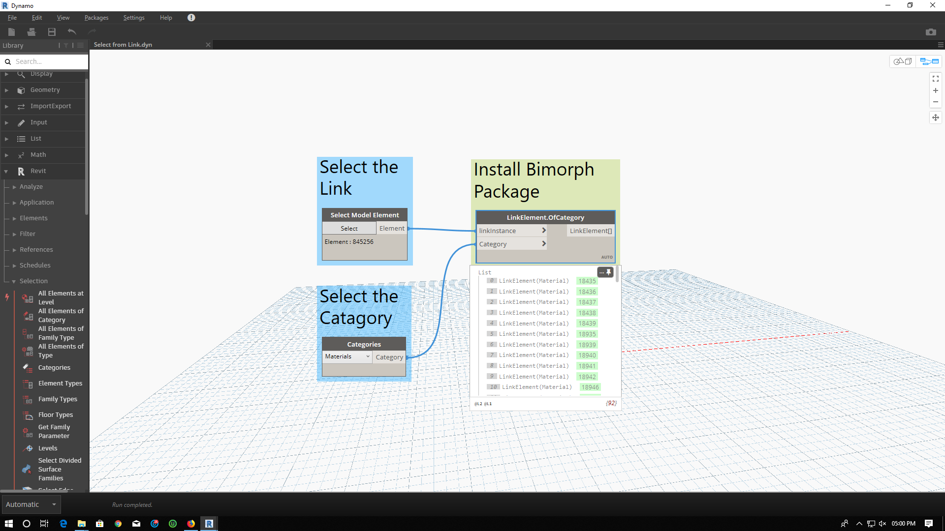

I cant see Revit is upto this level yet that we can select all instances from linked revit model.
if anyone struggled in this and found workaround pls share with me
Else please vote this post so Autodesk can seriously look at providing this feature.

Hi @Anonymous,
What is your end goal ?
You can select element from link using dynamo and bimorph package based on their category then further you can filter the list based on their type.Please find the attached image.
