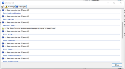

I'm trying to learn how to use the Revit-Robot link and this warning appear:
I have already search and in the others Revit versions they have a "Extension" tool to change the region. But now i cant find in this new version of the Revit 2023.
Can someone help me pls?

as I understand you used "direct integration" in Revit-Robot Link. Make sure that both - Revit and Robot have the same regional settings. If you are using the US environment in Revit, set the same in Robot, so e.g. units will be coherent.
Alternatively, you can just units in your RSA model.

Revit Structural Extensions used to be released till version 2018.  Then they were discarded.
You may neglect the warning it doesn't influence the transfer from Revit to RSA.
