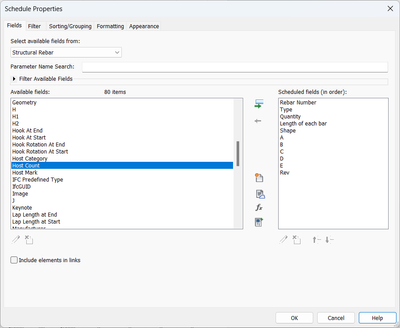

I have 2 similar foundations with rebar, in my bending schedule i am trying to show bars per member, can someone please help me with the formula to get the bars per member, it only shows the total bars of both foundations combined, which i also want, but i am also adding a column for bars per member.
526 Views
8 Replies
Replies (8)
Message 2 of 9
jay_colcombe
You can utilise the Host Count Parameter - You can create a Calculated formula to divide by the Host Count or Break down per Host
Jay Colcombe
Autodesk Certified Instructor
Message 3 of 9
rnelBFQS6
Thanks for the reply,
So what i did was, i created a new formula, quantity/host count but it still does not add up to the correct amount, in the model, i have shape codes 38 12off in all directions, top and bottom, which add up to total of 48 shape code 38 same lengths, if i do the host count/quantity, it takes only the 12 and divides that.
Message 4 of 9
jay_colcombe
For Quantity are you Calculating Totals?
I used this method
Jay Colcombe
Message 5 of 9
rnelBFQS6
Aaah, i missed a step, i never switched on the "calculate totals",
Thank you so much for the asistance!

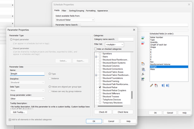

Antoher question, the total mass of each dia bar, is there a way to propegate that in the bending schedule?
Message 6 of 9
jay_colcombe
You have a Parameter for Reinforcement Volume so again with a calculated Value using this and a value for the weight of the rebar should work
Click on Calculated Value button and insert Density of rebar as constant value (7850 kg/m3)
Jay Colcombe
Message 7 of 9
rnelBFQS6
Ohky so if i add the "Reinforcement volume" field, with "calculated totals" it will show up in the bending schedule as a 1420cm3, do i add another scheduled field with calculated values to get the rebar mass?
Message 8 of 9
jay_colcombe
Yes you have to as the Weight/Mass of the rebar to be calculated by the Value to get the overall Mass value
Here is a quick google search of a similar process so you can either create a Parameter for the Weight/Mass or just type it in manually
I created a Parameter for Weight
Then a Calculated Parameter
I then entered a Value into the Weight Field in the Schedule and the Mass is Calculated
Here is an example just using the Weight Value - Calculated Parameter (7850 kg/m³)
