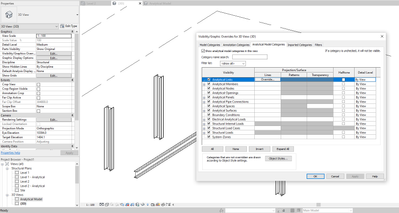

In this new version I cannot see member analytical model ... and also I didn't see the option to turn on/off structural option for column and beam too. What's happening ?

In Revit 2023 we now have Analytical Driven Modelling, this differs from the derived analytical model as contextual analytical elements are not created automatically when the physical model is created.
Revit 2023 has a new Automation feature to generate a structural analytical model based on selected physical elements.
