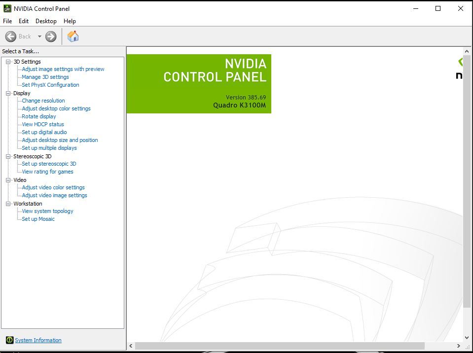

What are the specs of these two workstations ?
Ram, CPU, Graphics Card (did you install the latest drivers and did you disable nvidia's "nview"?),...
Message 13 of 23
I think I saw that during the installation of Revit that it installed 4.6.2 .Net framework
I have not disabled nview.
My computer is HP Zbook 32GB RAM Intel i7 4810MQ @2.8GHz 2.8GHz with NVIDIA Quadro K2100M graphic card

-FDC-
Check the Nvidia drivers as well (you never know)
Message 16 of 23
I have Version 4.6.2 of .NET framework and Driver version 361.80. I tryed to turn of the hardware acceleration in the Revit options but it had no effect on the processor.

If you are sure Revit is using the Nvidia (not the built in intel graphics "card" in the processor) I would try to install the latest nvidia drivers.
Message 18 of 23
just installed new driver now from Nvidia version 385.90 and it still is running full time.
