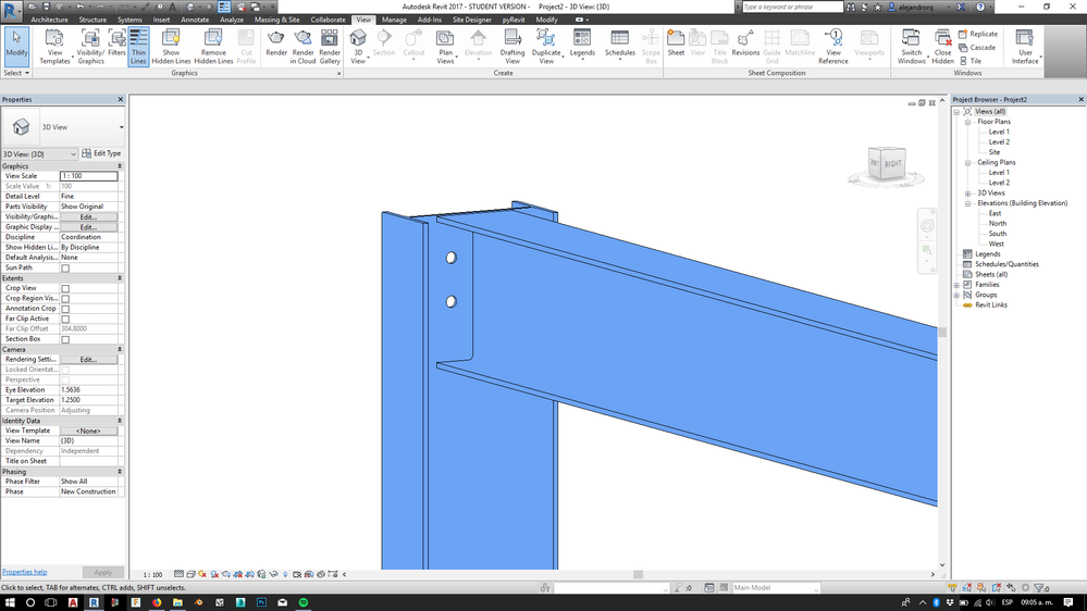

alejandrorq
I HAVE THE SAME PROBLEM I CAN SEE THE HOLES OF THE CONNECTION  BUT ONLY  I ACTIVATED THE REVEAL HIDDEN ELEMENTS (RH) I CAN SEE THE CONNECTIONS, THE COLORS ARE JUST FOR SEEING BETTER THE ELEMENTS, ALSO I CHECKED THE VISIBILITY/ GRAPHICS AND I CANT FIGURE OUT
Message 73 of 77
alejandrorq
I HAVE THE SAME PROBLEM I CAN SEE THE HOLES OF THE CONNECTION  BUT ONLY  I ACTIVATED THE REVEAL HIDDEN ELEMENTS (RH) I CAN SEE THE CONNECTIONS, THE COLORS ARE JUST FOR SEEING BETTER THE ELEMENTS, ALSO I CHECKED THE VISIBILITY/ GRAPHICS ALSO I CHECKED THE LOD AND ITS IN FINE
I CANT FIGURE OUT

Message 76 of 77
mihai.sandu
Hi Alejandro,
I believe that you started from a different template then Construction or Structural.
From the View's Properties menu, can you change the Discipline from Coordination to Structural.
Can you confirm that this is the cause of the issue?
Regards,
Mihai Sandu
Sr. QA Analyst
Message 77 of 77
