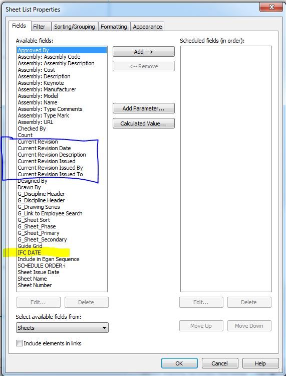

SeanSpence
There are only a set number of parameters available for the revisions schedule. And unfortunately all of them are type based
SO the revision Schedule that appears in a title block wont have the flexibility of showing separate dates for each as you are suggesting.
Something you may want to do though is create a sheet index on a separate sheet. Those have a much greater selection of parameters to choose from. you can even create your own project parameter and assign it to sheets.
Below are the parameter for sheets out of my current project. the blue are the system parameters for revisions. the highlighted IFC date is what I use to keep track of when the sheet was originally issued for construction
