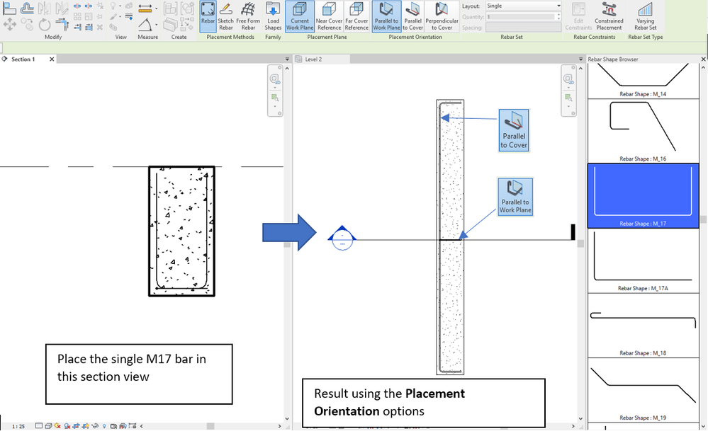

I need an explenation about PLACEMENT PLANE OF REBAR : CURRENT WORK PLANE,NEAR COVER REFERENCE,FAR COVER REFERENCE .
and PALCEMENT ORIENTAION : Parallel to Work Plane,Parallel to Cover,Perpendicular to Cover.

The Placement Plane defines where the rebar is placed in the host.
If you have a structural element cut by a section view and you are placing the bar in that section view, you will get the following results when using the 3 placement plane options (depending on the view direction, the farthest face of the element, the current cut (work) plane, or the one "closest to the screen")

The Placement Orientation defines how the rebar is aligned when placed in the host.
It's how the bar plane is positioned when you first place the bar.
The same example using some of these options:
My advice for you is to play around with these options and see which one works best in a given situation.
Let me know if you have any questions.

thank u for this great explanation!
according to last image what is  the difference between work plane and cover, isnt  the same?
