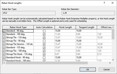

Hi everyone,
is there some way in Revit you can automate the rebar hook segment lengths to adjust according to the diameter?
This was implemented in Autodesk Structural Detailing:
The hooks segment lengths would automatically change to the correct size when changing the diameter:
In Revit this has to be done automatically, but I was wondering if it could be automated as well?
Another question: when changing to another diameter the hook segment length also seems to change by mm?
If this happens, this means it CAN be adjusted right?
See below: the same rebar Ø12 changed to Ø14 results in hook segment length of 15,10 ???

Hi @semi
The hook length for each diameter is defined in the hook types menu.
If you set it to auto-calculation, it will use the hook length multiplier, defined in the hook type, to compute its length by multiplying that with the bar diameter.
If you want to report the hook length (for schedules and properties palette), you need to set one of the parameters with the formula to report Start / end Hook Length, offset length or tangent length.
I see you included the hooks in the shape definition. This means that when you add a hook to shape 00, a new shape will be created. If a new shape is created (in Revit 2021 or newer) the hook length should be added automatically to one of the shared params (A, B, C).
If you would not include the hooks in the shape definition, but would still want to report the length, you can edit the family of shape 00, without adding any hooks in the family, you can write a formula "=Start Hook Length" to one of the parameters. It will show 0 until you also add a hook to the bar.
To test any reports of the hook length, like in your first post, try to measure using a dimension placed manually on the bar, like it is depicted in the page below (for each hook bending angle) to see if the reported length is the same as what you are measuring.
https://help.autodesk.com/view/RVT/2022/ENU/?guid=GUID-5E2D4E9E-45D9-43E7-8E57-7BEFF4C9D9DA

Hi @semi
You don't have hooks assigned at the ends of that family. A and C are driving the segment lengths. Their values change because the diameter changes and the dimensions are measured to the exterior of the bar.
To change this to hooks, you can edit the shape family, delete the two segments and add 90 deg hooks. After this, set the formula for A and C to be equal to hook length (or tangent length).

ovidiu_paunescu
Well, you can set the length for each hook type, when placed on a certain diameter or you can define it to auto-calculate based on that multiplier and the value of bar diameter.
You can do that by type, to set it up for your project. If you want to use the hook as an end segment, you can override the hook length and manually input a value, just for some bars.
