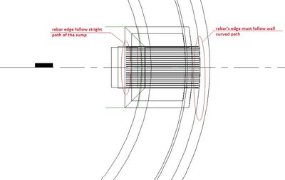

I want to draw radial distribution of my rebar shape according the angle 9.731° us shown in the picture below
I have not found another solution to draw a radial distribution of my rebars than by using a radial array!!...but when creating array I can't modify my rebars (each rebars became a single group and thoses properties are not shown on properties tab and my others rebars are hidden in 3 D view?)
PS: I've sketched my rebars shapes because I can't create them with aligned function in Revit due to my sump shape created as a generic model that nest and cut my slab, in this case the selected wall faces don't give me the shape I want.
So How can I create radial distribution of my sketched shape like the aligned function in Revit and keep their properties to modify and schedule them in a table?

When you array, uncheck the Group and associate and they will neither be grouped not associated to the array...

You hid them in the view...click on the Bulb to Reveal Hidden elements >>> select and from the Ribbon Unhide them
Message 7 of 13
ovidiu_paunescu
Also, if it is possible, you can duplicate the geometry of the tank, without the sump and reference that to create the rebar using aligned distribution free form rebar.
You can then hide that geometry.
You can also use free form rebar shape matching, to have the bars matched to rebar shapes in the project and extract the segment lengths.
This way you can change the spacing or number of bars, unlike the array, where if you ungroup, you have to recreate in order to change the number of bars.

I still stuck to find solution of my problem!!...anyone can help me to model my rebar shape as I indicated on my post above?
I tried various host geometry to model my rebar shape but it's not matched as I want!!... I receive a warning message saying me that my rebar is out host!! (I can't add horizontal upper edge of my shape as shown below)
In fact, I want my rebars intersects as shown on picture below like in staircase case(scissor rebar) and in the same time I want maintaining the curved path of the edge on the extremity as in the pictures below
(I don't want to use array distribution of sketched rebar because it does not given me possibility to modify the whole of the rebar's spaces and numbers)
