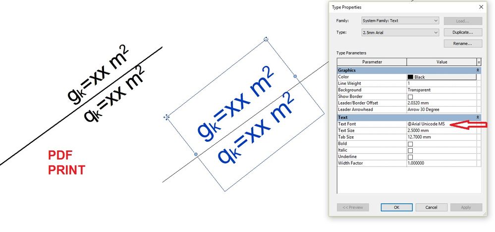

When printing text in slope it opaques it self,  why?
Attached example.

@GatisM hello, try to use another printer driver if the problem still occurs. thanks
GatisM
Tried 3 differnt printers, it doest help.
ennujozlagam
@GatisM hello, can post some part of it so we can check. thanks
GatisM
PDF creator,  CutePDF writer, PDFill PDF&image writer. I think it is not a printers problem. Attached example. Did you try on jour revit?
ennujozlagam
@GatisM Hello, I'm not too sure about this, it could be a bug in Revit 2017. The only thing you can do is change the "text font" and the text will print in pdf. hope it helps. thanks
