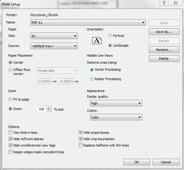

I'm having issues when creating PDF's on a particular project and was hoping someone had a fix.
The first (and worst) issue is that dashed lines appear to have duplicate black lines over, when using 'Vector' processing.
If I use 'Raster' processing this cures the duplicate line issue but the print quality is terrible and not suitable for linework.
I've attached a screen shot showing the issue.
The second issue is that insulation batting lines print as green instead of the defined colour.
I've just tried using a new PDF creator to see if that helped but I'm getting the same results!
If anyone has any ideas of how to cure these, it would be much appreciated.

  1. Can you post a screenshot of your Print Setup?
  2. Which PDF Printer you are using and which Windows OS do you have? Lots of PDF creators are experiencing problems with vector processing on windows 10. Adobe Acrobat DC seems to work though...You might need to check if you have you applied all updates; otherwise try to remove your PDF printer and Install trial version from Adobe to see if it solves your issue
  3. Raster Processing if set to High or Presentation it should give you a 90-95% similar quality to Vector Processing...Most of my PDF prints I do using Raster...and its quite surprising to see someone say its that terrible.

I am using Windows 7 64-Bit, with an AMD Radeon R9 200/HD 7900 series graphics card. Also, I'm now using PDF Architect 4 to produce my PDF's.
As DanFaba and yourself pointed out, I needed to update the drivers. Once these were installed it cured the majority of cases.
The colour issue has been fixed for all prints. The strange dashed lines do occur, but only on odd drawings, so I'm content to use Raster for those.
I have attached a couple of screenshots showing my printer settings, just in case I'm missing something.
Thank again, much appreciated,
Andy
