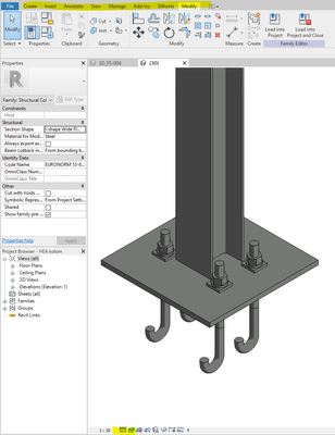

I have modeled an structural object in revit, then I exported as .sat file. Now I want to import the .sat object into a revit family. As shown in photos, in revit environment I have assigned materials to the element, but the material -or in general visual graphics- of the element is not visible in family environment.
I would like to ask, how should I fix this problem?

Actually, we want to bring the entire structural element inside the family. The parts like plate and bolts are made by Connection toolbar in revit which is not available in family environment. that's why we made the model in revit project environment then converted as another object to be importable in family.
Another option we tried but didn't work, was exploding the connection element and make it as group to be importable in family. But it shows error that cannot group the plates and bolts.
I hope the explanation made it more clear. Thanks again for your attention.

A SAT exported from Revit only contains 3d solid geometry, nothing else.  You might one to export the connection to IFC instead.
