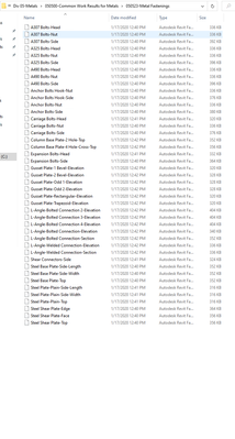

See, this has already been addressed, and this same answer has been given.  The answer does not solve the problem.  The missing content is not included in the downloads.  Please update the missing content, i.e.
Division 05-Metals / 050500-Common Work Results for Metals / 050523-Metal Fastenings ... all the nuts, bolts, anchors, etc that used to be included are currently not included.

I have just redownloaded the RVT2021_ENU_Imperial_Libraries.exe to a workstation without Revit 2021 and once extracted I have families in 050523-Metal Fastenings as depicted in the image.  Are you not see the same?
