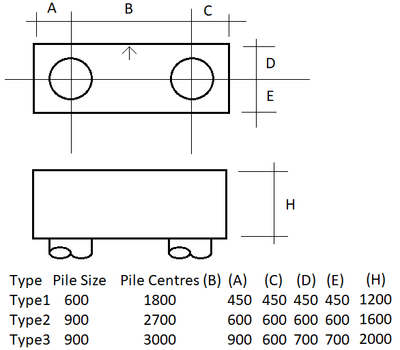

RPTHOMAS108
Pile caps are pretty standard, typical details could be done as detail items on a drafting view.
Usually would have a set of details with alphabetical dimensions and then reference those lettered dimensions in a schedule generated from the pile cap types within the model (with same lettered parameter names).
e.g.
