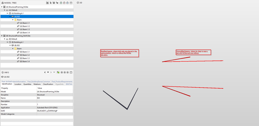

In Revit I've made two sets of beams. One set modified with the miter function and one unmodified. The project elevation is repositioned, to 5000 mm above startup location.
After this, I exported 2 Ifc-files: One with IfcSite, and one without:
As the image depicts, the Mitered beam sets are place on top of each other, and disregards the IfcSite upon export.
