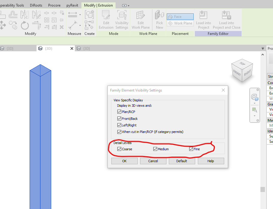

Hello! I'm pretty sure, that somebody knows the answer 😉
I'm not even able to click on beam after select "JoinGeomtry". Is element unjoinable? I have to join beam with floor. Beam is made from concret, floor - precast. Of course, functions Cope and Cut don't work too. Maybe, is some family parameter unchecked?

RyanS_HAA
I'm having the same problem as the OP here, what am I missing? Why does the join tool IGNORE beams? The issue is not differing materials, it's that when you mouse over the joist (even if it the first object your trying to pick) Revit doesn't even highlight it for selection.

Extrusion or Sweep does not matter.
If you want to join geometry a beam and a column in the project, edit the families and set the 3d extrusion or sweep to be visible for ALL detail levels.

RyanS_HAA
Finally! Many kudos to you ToanDN!
