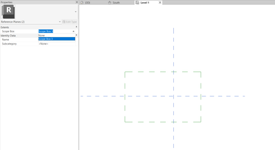

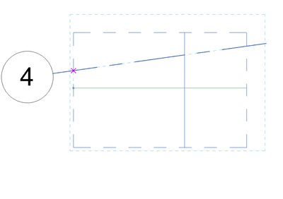

I couldn't find a way to rotate the Existing scope box align with nearby element.
Image attached for your reference.

Message 6 of 30
jay_colcombe
I may be repeating or missing a step but I simply select the Scope Box and use the Rotate Tool, this allows me to position the node exactly on the element I wish to align against, set the angle as Horizontal and roate ontpo anoth element node and the Scope Box orients accordingly.

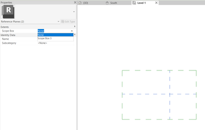

jay_colcombe
I appreciate the dilemma now so unless you drop the node on the intersection between the Gris and Scope Box and eyeball it by zooming in its not going to be 100% precise.
The only alternative I can think of is you Create a New Scope Box use Reference Planes and Assign them to then Box then Unassign to cut them down
You can then use Model Lines > Pick Line > Click on Reference Planes and not you have reference points to move and position the Box & Model Lines (select them All)
You also get additional snap points
I am sure there is possible an easier way through the View and Crop Region or an Addin?

Message 10 of 30
Yes you can. Use rotate tool, drag the base point into an edge of the element, then you can rotate to align with the element.

bryan_mentzel
Go to original plan view where Scope Box 1 was placed.  Go to plan view Properties box and set Scope Box to None.   Select Scope Box 1 in plan view and say you want to rotate it 5 degrees counter-clock-wise (CCW).  Start the rotation, then rotate the Scope Box clock-wise (CW) and accept.  Yes, you are rotating it (opposite direction) bass ackwards of what you might think.   Also, Revit automatically gets rid of Scope Box 1 and creates a new Scope Box 2 on the rotation.   Enjoy.   Also, see link https://help.autodesk.com/view/RVT/2025/ENU/?guid=GUID-7783971E-9DEC-4BEF-BB57-A992C94745C4

Message 20 of 30
Delete that rotated scope box. Create a new scope box not rotated. Then use my method to rotate it aligning with the angle of the element.
