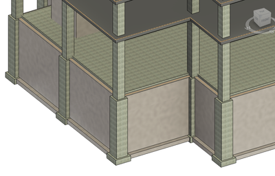

I have two questions:
1- How to model the curved beam using the Segmented Analytical Model Parameters ( as a continuous curve analytical model, or approximate it with a series of straight line segments).
     I already found a link discussing it but I did not find it in the program.
2- How to model a column between two RC wall panels.
   every time I model it, the column disappears or transfers to the top level.

1. See https://help.autodesk.com/view/RVT/2022/ENU/?guid=GUID-0AF3EAB9-D369-4C07-BAAD-CB1EE2DEC7B2 and https://help.autodesk.com/view/RVT/2022/ENU/?guid=GUID-2F59BBFF-E172-4314-B561-D68E1E6EBCA1
Starting with Revit 2023, this option is no longer available.
2. At a first look, I would say you need to check the settings from the Option bar (see attached picture)
