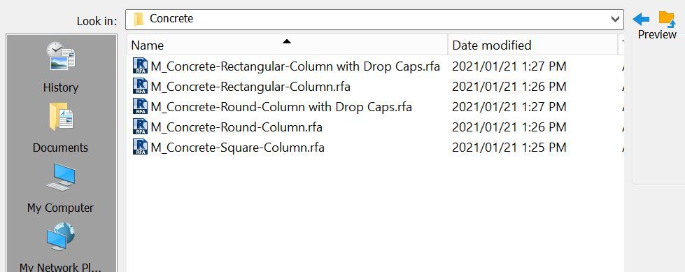

I'm trying to add M-concrete- square -column to my drawing, but first i have to load it, but i can't find it in revit library. How do i get it?

1.)Go into your Revit Project click on column and click load "family".
2.) Select "US"
3.) Select "Structural  Column" and select "concrete"

it work i think, i had to download the us library. thanks alot
