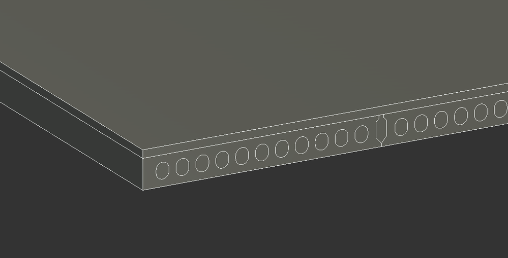

Hi there,
I would like to create some custom Hollow core slabs with the Precast tool.
Everything is working fine except for the profiles because there are no profiles generated on the side of the slab.
Is there any posibility to automaticly fix this so all my hollowcore slabs get the profile generated on both side of the slabs?

Hi @j_kuhlmann4JCX6,
The profile are based on segmentation with parts. The ends do not have so one possibility would be for you to manually add some profile that would match the inner profile at the ends of the slab.
