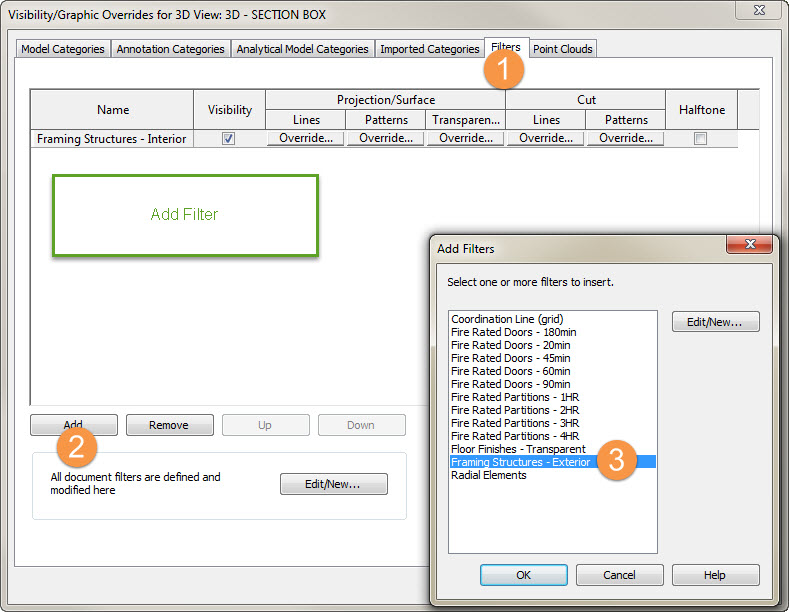

So i have this building that jogs a lot on one side and I need to show only the exterior framing structures. I know how to use worksets, splitting segments  and hidding interior columns and beam but is there an easy way to produce a framing elevation that only show the exterior structure when a building jogs multiple times instead of hiding  elements on a worksets, and hiding elements in the interior of the building one by one?

Your methodology with worksets should work fairly well.  I typically don't recommend that worksets are used for a layer or visibility control.  What happens is that someone will leave that worksets as the active workset, and several elements accidentally get placed on that workset.
The more appropriate solution is to use view filters.  These view filters can be used to create "rule-based" visibility graphics settings.  Hence, you can assign a custom parameter for the frames so that only those objects show in the view.  Give them a try.  You'll find them in a tab within the Visibility Graphics dialougue.

Say like add a yes/no parameter to differintiate exterior structures from the interior ones that i can use to filter it?  That's a very great idea! why didn't i thought of that!!!! 🙂

I am not able to add the parameter to the filter. I have used project parameter, shared paramter, added the parameter to columns and beams but I couldn't fifilter them. can you show me step by step on how you do it?

Try the workflow shown in the attached images.  I recommend using a custom parameter that is a text parameter instead of a Yes/No as this will provide you much more flexibility.

It's in step 5 where i stalled. I'll give it another try.Thank you so much!
