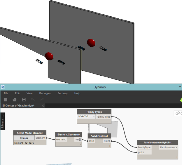

However with the use of Dynamo, things can be done
Can this be done for the whole model itself or just geometry?

Hi there,
True, dynamo can deliver
As far as I know currently COG is based on geometry only:(. I would be glad if someone can prove me wrong and say COG can be calculated based on weight:))
Message 53 of 78
bradwitt
​I have developed a script for Dynamo that is based on weight. Their needs
to be a weight parameters in the family and needs to be an instance. So far
it has been working well.
Brad​
