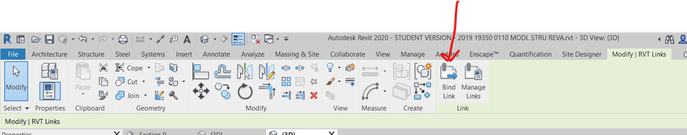

MostafaElashmawy
I think that what @robertwmerriman2  is good but with one more step at the end.
save your file with anew name then delete everything except the required elements that will be used as group.
In the old file, from insert tab>>click link revit>> origin to origin and select the new file.
after the file is linked, select it and click bind.
now the linked file will be changed into group.
Mostafa Elashmawy
Message 7 of 9
arautio
I tried this,  it will not allow the link to be bound.  Says error..  Probably because Steel cannot be put in a group (which is the biggest bunch of bull I have encountered in Revit)   So how do you get steel members to be groped or assembled into individual repeating configurations???????????
