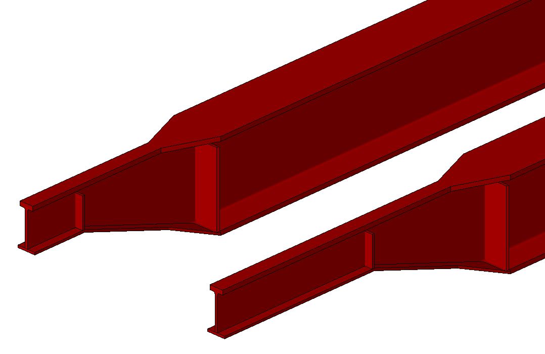

So you know, it is entirely possible to do what you describe as part of the family, it does require some advanced family creation skills that can really only be taught by trial and error. The attached shows a custom haunched beam family that we created for my work, what is pictured is the same beam with difference haunch values. it uses voids in the family tied to reference lines and planes plus a slew of formula driven parameters to adjust as the depth of the huanch is changed. HAUNCH BEAMS.JPG

While creating haunch beams, which template shall we use? I tried to model haunch beam in Metric structural framing- Beams and braces but as only left and right elevation can be used for modelling, haunches in the front elevation cannot be modelled. Then, I tried from Metric generic Model. However, I was able to create but at the end, beam details and schedules does not appear. What could be the solution?
Thanks in Advance.
Message 9 of 10
Honestly i started with the out of the box Wide Flange family, i suggest
doing the same with whichever family you need.
Message 10 of 10
tuladhar.prerana
Thank you. But , I could not find that Box wide flange family.
