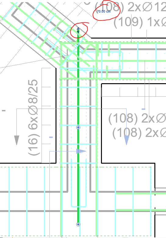

I'm using this type of constraints a lot (middle stirrup):
Could that be the source of my headache? I realized everytime I start messing with middle stirrups constraints revit keeps slightly changing bar lengths!

ovidiu_paunescu
When copying a rebar, Revit tries to find to most suitable constraint (an element face for each constraint handle).
Changes to the bar might occur by trying to keep a certain distance to those automatically selected faces.
In your example, if you edit the bar constraints and click the end handle, you will see that it is at 70cm from a face (not visible in plan)
Since 2018, you can edit the bar constraints in 3D.
For this example, isolating the bars and host, looks like this:
You can edit those constraints and set them to the same faces and offsets as the neighboring bars
There shouldn't be any issues if you are using the constraints to the corner of stirrups. To have those available, the transversal bar needs to have the style set to Stirrup/Tie.
For the wall corner reinforcement you can try on a similar arrangement of walls, but in a new project.
This way you can eliminate the possibility of the bars constraining to some unexpected faces.

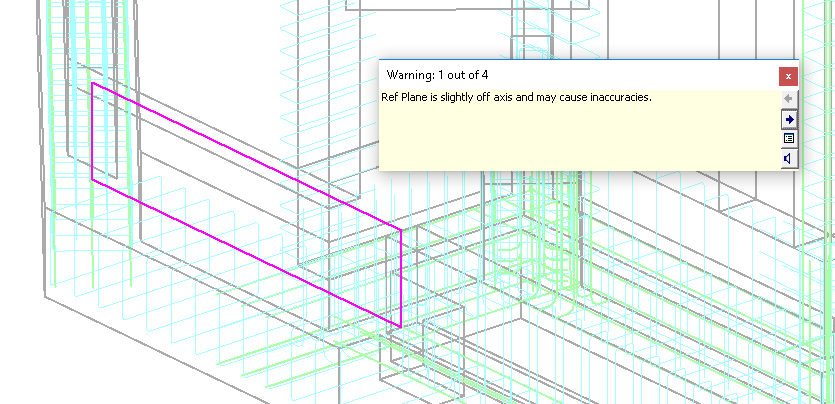

ovidiu_paunescu
Hello @Anonymous
It seems that the 65cm wall is slightly off axis. Maybe when you drew it or copied it into position, it got shifted by a small angle.
You can see this if you click edit profile in the 3D view for example.
This causes the lateral faces to not be perpendicular to the section plane and the dimension cannot be created.
I've tried deleting the wall along with foundation and recreating it. Of course you would need to re-host the bars before, so that you do not lose them.
This works.
I guess you could also draw some detail lines over the edges and dimension to those, but this would not be elegant.

Message 19 of 19
Thank you Ovidiu!
I've redrawn 65cm wall and its foundation and now everything works.
