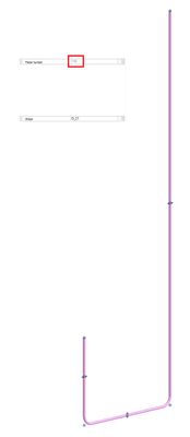

I've tested your theory. Indeed, the rebar number changes after the coupler is added to the rebar on one of the ends. But with a nuance.
On the screen below rebar before adding coupler and rebar number is 118:
On the screen below the rebar number has changed on 289 after adding coupler:
On the screen below the rebar number has not changed and still on 289 after adding second coupler and this is a little nuance:
We need to know these nuances of the mechanics of the rebar in order to take into account our moments when preparing design documentation.

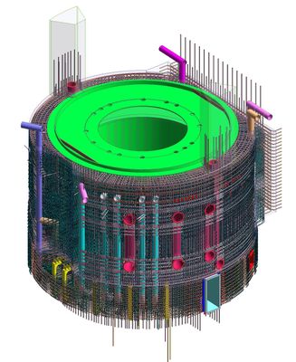

Because we are developing very specific and unique structures like this:
We also have questions about ring rebar and we would like to get support on this theme too.

The way numbering works is by comparing the values of A, B, C.. parameters for bars that have the same shape and are in the same partition.
The start/end flip of the rebar shape happens, so that two bars with the same shape and A, B, C values (and same rebar number) will have the ET on the same end.
For example, if you add a coupler to a bar with shape M_17 and B=300, C=400, D = 500, at the start, then for an identical bar you add a coupler on the end, that second bar is flipped, start becomes end, and B=500, C=400, D=300. So it gets a new number. If it didn't and you would show these bars in a schedule, the ET would show varies, because for one bar it's at the end, for another it's at the start.
If the ET would be included in the shape, a new shape would be created and would get a different number
When you are adding the second coupler, the bar is not flipped, so the number doesn't change.
