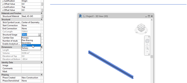

Sometimes things are only added when loaded into the project and not in the family itself.
However you can manipulate the lines in the project (or project template)
For example this beam has "Structural Usage" = "Other"
When I go to Visibility Graphics Overides I can override the linetype for that sub-category
Louis
PavelAnd
Hi @info. @L.Maas is right, but also don't forget use "pveriew visibilyty" mode in family.
