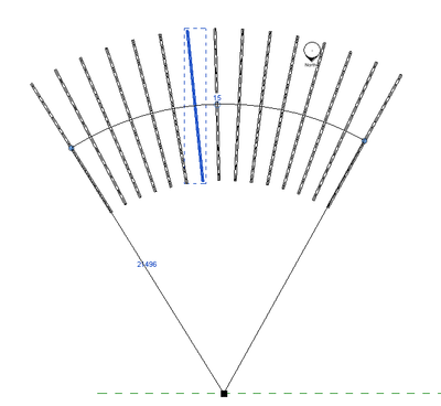

Does anyone know how you can create a beam system for an arc building? Or if there is a work around rather then placing the beams one by one?
I have a U shaped building and want the system to follow the curve.

Thanks for your response, But I actually am talking about about a curve on a horizontal plane. I have attached a picture as an example on what happens to my beam system and I am wanting it to follow the curve.
EdwinG
not with beam system.
use one beam and then a polar array.
