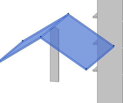

Attach Column to a 2 sloop floor
freitas_Goncalo1994
Can't seem to attach properly a column to a two slope ceiling. If i do a normal attach to top i get image "Problem 1", if i create a reference plan and attach to top using that reference plan i get the images "Problem 2" and "Problem 3". Help would be highly apreciated

1 - Select Column (Picture 1)

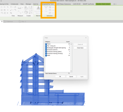

2 - Toolbox -> Attach Top (with maximum interseption) (Picture 2)

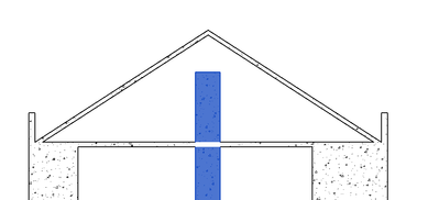

3 - Press on the floor to attach. The problem is that i dont get the same result has you did, i just get the result showing on Picture 3.

It's not the best model as the lines and not truly vertical and planar so you have small offsets and errors causing the problem as it cannot cut correctly (as below)
you need to review why these lines are not truly Vertical and Horizontal as this will only cause more errors later especially if you are looking to esport to analytical programs.

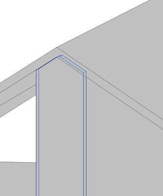

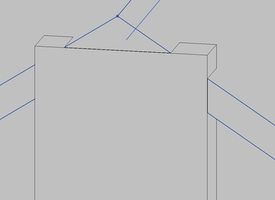

Making sure the Roof Covers the Column to allow it to be cut
This Grid is Vertical in comparison to the Roof Edge
Again to show it does work in your model with the correct alignment I created the same example where the roof covers the Column so it can be cut to the underside and it works as expected.

If you don't see it there, then there's still an instance of it somewhere in your project, and you'll have to hunt it down and easy way is a 3D View with everything turned on window Select everything then use the Filter Tool to pinpoint the item
